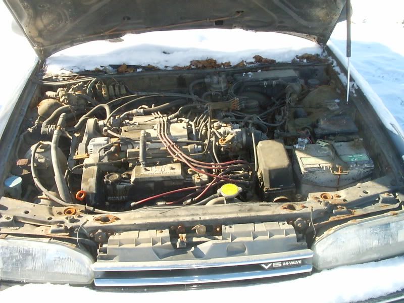

it's not an easy swap
first, try to find a 5 speed manual legend 86-90 ... with a good tranny, clutch, flywheel and syncros
then strip out everything, engine, tranny, axels, shafts, rods, tranny mounts, engine mounts ...
then shave of a chunk of intermediate shaft, shave off a corner of the stationary axel hole, then make custom driveshafts since legend ones are too short and accord ones
anyways, there is a lot of work to do
BTW : I'm the one who sent that info to metric exr like 2 years ago

I have no doubt about the fact that it's a lot of hard work.
It's nice to see things being done to this car "5th gen v6"
I remember when I had mine, getting a simple cold air intake was a great challenge of information gathering and I was far from having the possibility to do this kind of engine swap
I'll try finding the post I made for the swap of a manual tranny in a 6th gen v6 ... I kinda based my reflection on your swap on it ...
Nonetheless ... great work
